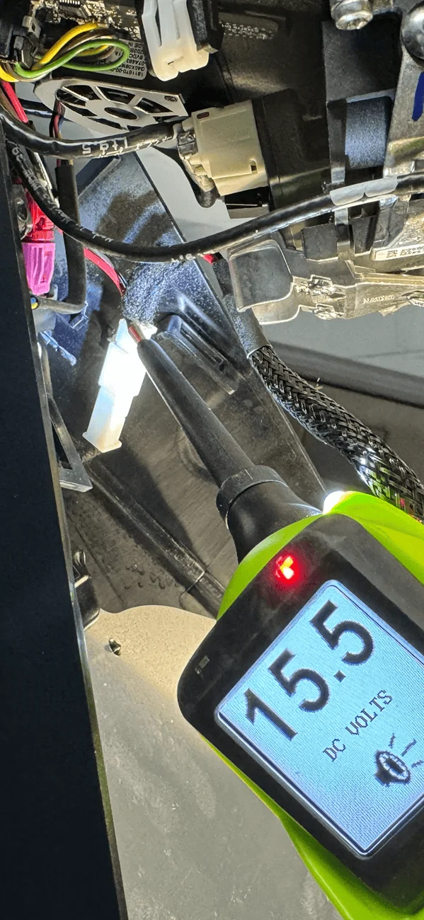

In case you are interested, you can install a 12 volt radar detector up next to your rear view mirror. There is a 12 - 15 volt circuit behind the rear view mirror compartment. It’s not necessarily easy to tap into the circuit, but it can be done if you have some mechanical skills.
