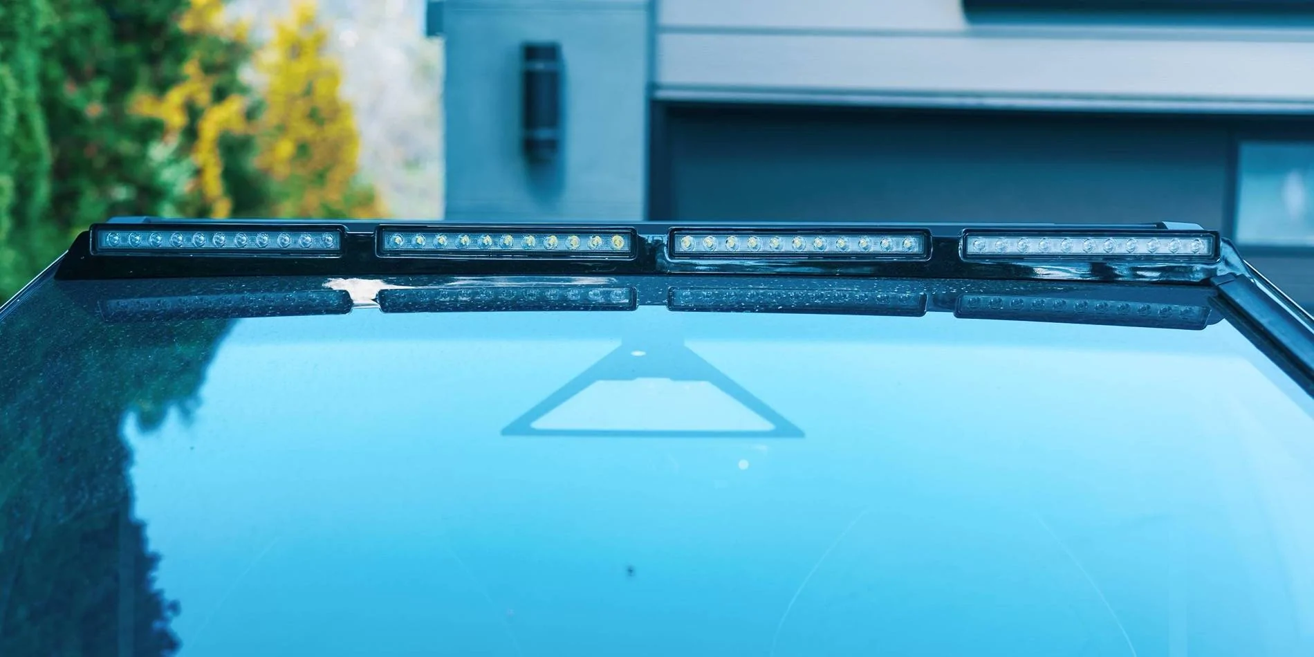

I just upgraded my truck with a Tesstudio lightbar. Instead of the traditional mounts, this one sticks directly to the windshield with adhesive tape, similar to the OEM lightbar. I actually prefer this solution—it's easier to install (though I'm not entirely convinced about UNinstalling, haha). Got it installed on the truck and tested.

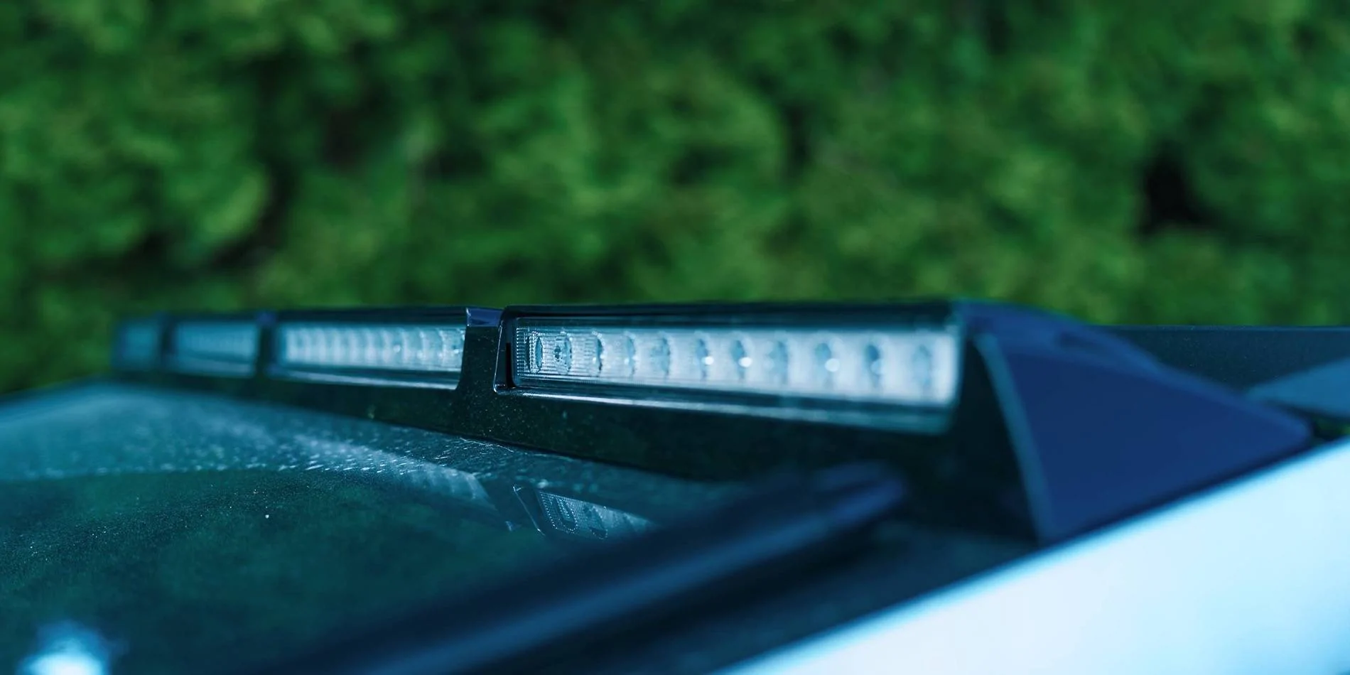

One other thing to consider, how much space you really have to work with. Yes, lower on the windshield might provide a little increase in aero benefit...but the wiper is also VERY close to the lightbar. Would be interested to see a side shot showing exactly how much clearance is left after the install.
Rain/snow/debris/etc are all pushed by that wiper arm, and if you install the lightbar too close I'd imagine you might run into other issues.
naah, that shouldn't be a problem, attached a couple of my images below

Thanks for the pics! Not personally a fan of the 4 separate bars, but do agree that the single piece looks nice integrated with the CT. Any pics of it later at night with the lights on?
As for the wiper clearance, that is what I was afraid of...very tight. Definitely would not mount it any lower on the windshield than you did. Not sure how it will affect rain/water flow, but snow will definitely accumulate and has the potential to cause issues.
