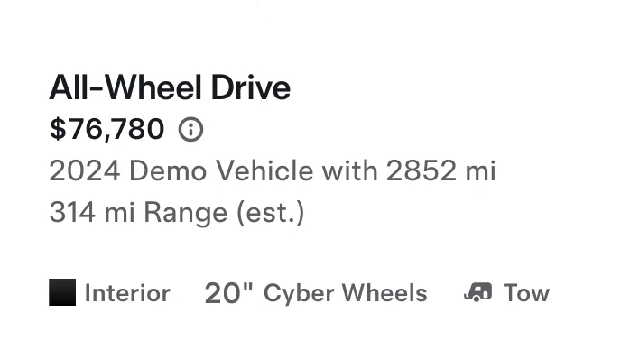

Please post screenshots of the two vehicles you are comparing.
FS AWD AT: 318
Tesla Cybertruck FS AWD Dual Motor - Really Getting 20 Mi More Range? SmartSelect_20250331_114706_Firefox
AWD AT: 314
Tesla Cybertruck FS AWD Dual Motor - Really Getting 20 Mi More Range? SmartSelect_20250331_114723_Firefox
AWD AS: 325
Tesla Cybertruck FS AWD Dual Motor - Really Getting 20 Mi More Range? SmartSelect_20250331_114741_Firefox

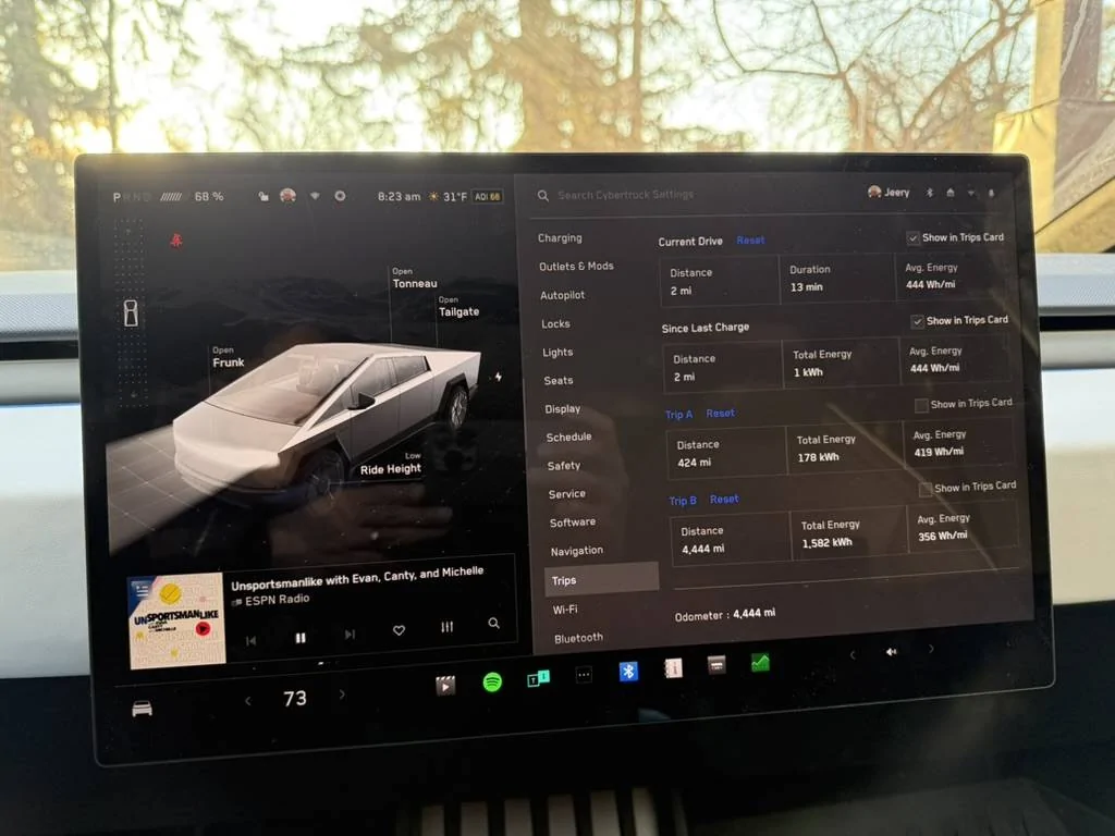

My real-world efficiency with my AWD is 3 mi/kwh in mild/hot conditions and about 10-20% less in winter. That's on all-terrains, mostly without the wheel covers (since I didn't have them) over nearly 10 months and 6,000 miles in the Northeast.
This was a few months ago, Trip B was winter, Trip A is basically lifetime.

AWD Foundation with CORE wheels is advertised as 340mi Range (EPA)
Thanks for posting this, it's what I'm referring to.

In warm/hot conditions in NJ I regularly average a tick over 3 mi/kwh for over 360 miles of real-world range on all terrains with no wheel covers. Now that I have wheet covers I'm hoping that goes up a bit.
If you're running core wheels with all-seasons I'd hope/expect to see better.
Because data, here were my first 2,000 miles and note the current drive at the top of 52 miles at 309 Wh/mi which is 3.24 mi/kwh. Multiply by 120kwh in the pack (subtracting 3 kwh for buffer and not running dead) and you're at 388 miles real-world. Again, on all-terrains with no wheel covers.
Tesla Cybertruck FS AWD Dual Motor - Really Getting 20 Mi More Range? 1743439612581-h
Your current drive is averaging 46.57 mph based on duration and distance. My beast gets that kind of mileage at lower speeds. I get that kind of range on my ~44-mile commute (6 miles at 45mph speed limit/the rest at 55 mph speed limit) with traffic.
But, on my 13-hour trip last week just got about 400Wh/mi down and back which is ~308 miles of range. I was also going... Well, I wasn't being passed.
Really shows that speed kills range.
