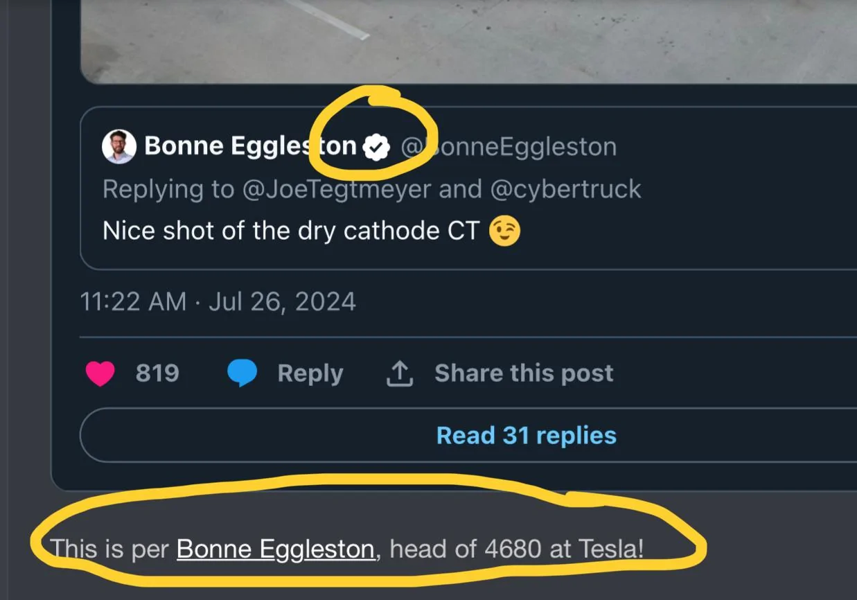

Sorry but how do we even know it’s a dry cathode cyber truck? Looks just like a regular cyber truck with a wrap. ?

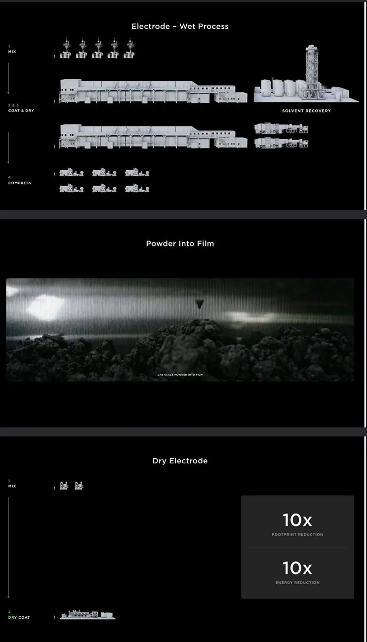

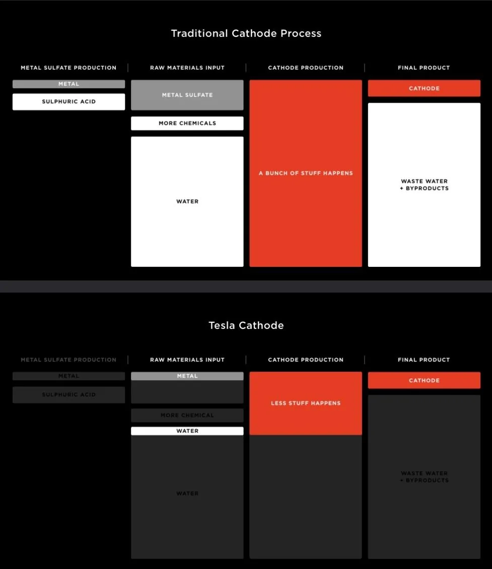

Clarification:
The cathode wet process uses a solvent which is reclaimed and recycled.
The new cathode electrode material generation process uses less water (zero net) due to skipping the nickel sulfate step, but that is independent from applying it to the metal foil.

Well that explains that! good to know for those that are not so involved with the topic. Thanks. ?
