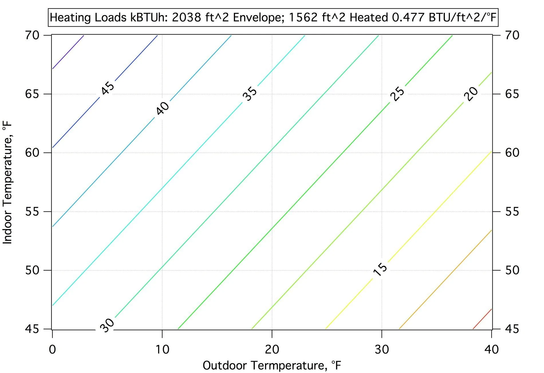

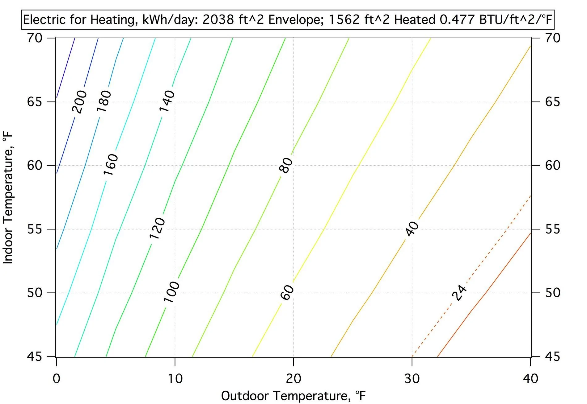

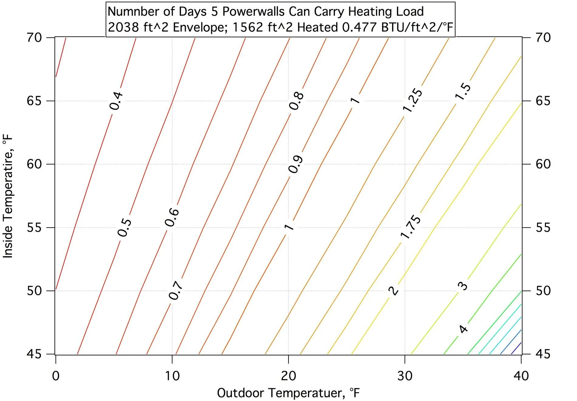

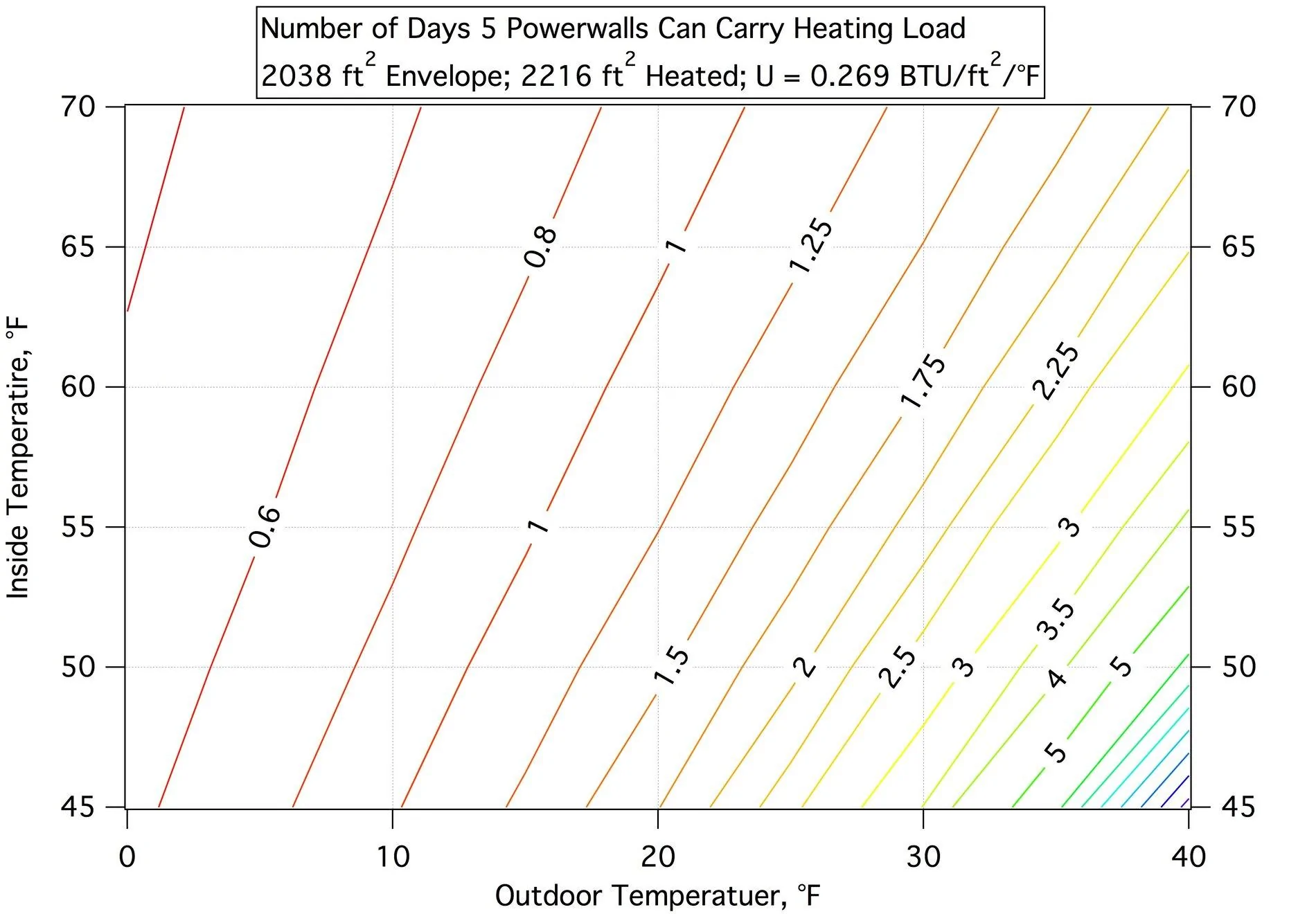

With a well insulated, non-drafty house of a normal size, I think you would be surprised just how much heat 4 or 5 Powerwalls could provide using an efficient heat pump, especially if only the occupied rooms were fully heated. Suitably sized solar would only extend the length of total power outage that could be handled. At this point in time that would be quite an expense for an emergency that may or may not happen but the price will be a lot cheaper as 4680 cells ramp into high volumes.I interpret that as; two EVs in one household, household electricity consumption doubles. And if heating comes from electricity too (probably heat pump) for a house, then three times the electricity consumption per household. ;-)

But seriously though I doubt a solar roof and even a string of powerwalls and a heat pump would have got him too far in those conditions. Better off getting out a good ole woodgas CHP.
