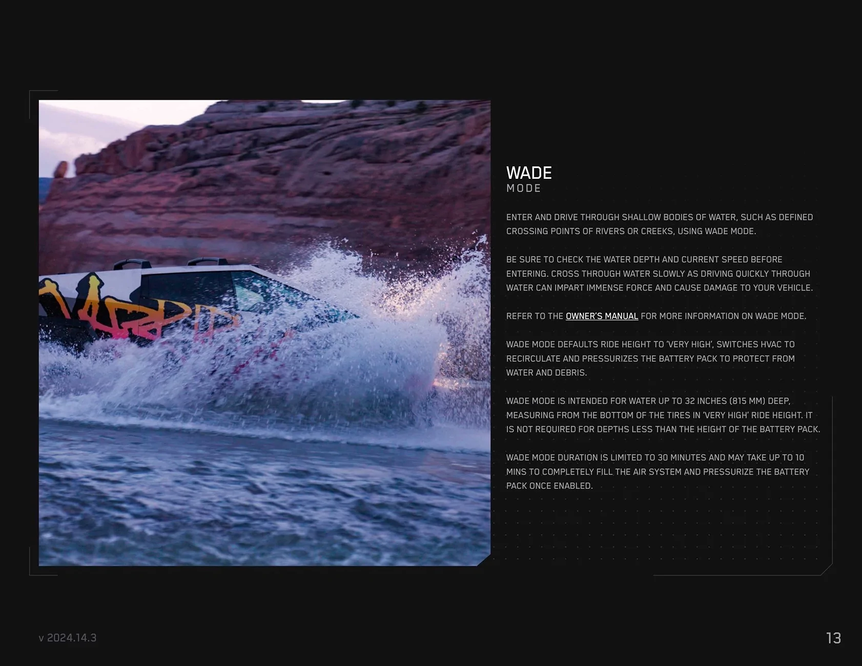

Although Wade Mode has activated for me without undue wait the couple of times I needed it, I believe the manual states it can take up to 30 minutes.
It operates for up to 30 minutes, it doesn't take 30 to be active (that's a bad data point from a YouTube video).

Could take up to 10 mins to fully activate, then can stay active for 30 mins
Tesla Roadster 2nd gen Delivery day - Air Suspension Issue IMG_7395
Thanks for the correction, I misremembered, it's 10 minutes, not 30 minutes!
My point remains, clicking on Wade Mode when inspecting your new Cybertruck, accidentally or on purpose, could contribute to longer fill times when subsequently raising from Easy Entry to Extract Mode.
I suspect there was nothing wrong with the truck but it's impossible for any of us to say with any certainty, even the original poster. That's why I would tend to defer to the opinion of the on-site Tesla Service Tech before I said they were "not much better" than a used car lot (without any solid evidence to back that up).
