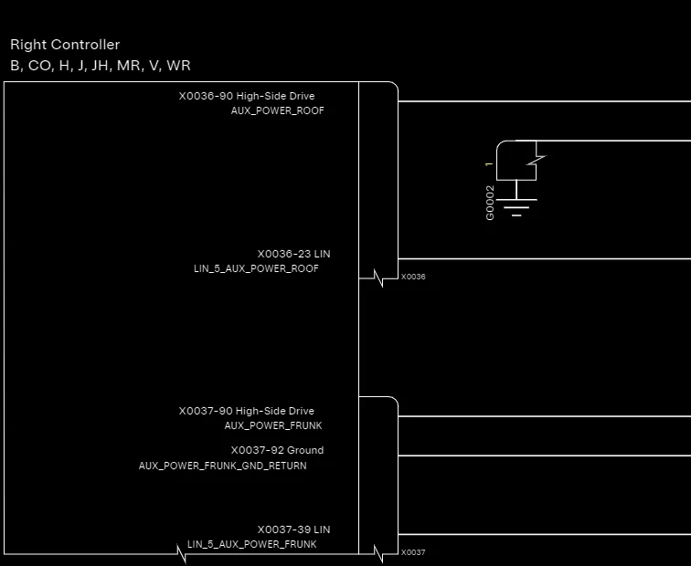

Hmmm. The roof power feed return is connected directly to chassis. However, the frunk power return actually goes to the controller. Both are 400W. I'd like to stick to 2 conductors, but if the return is not chassis gnd, then maybe a third terminal to chassis would be good. Anyone get confirmation on what the "LIN" wire is? I've seen several videos speculate it is for communication but I'm not so sure since all other communication is over twisted pair.

LIN is Local Interconnect Network, a single wire low speed (19.2 kbps max typ) bus.
G0002 is also the ground for the right side door modules and A pillar microphone.

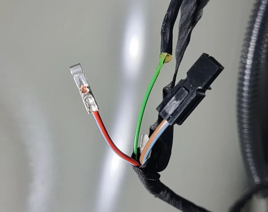

If anyone else wants to do this, I thought I'd mention that the 48V power is only 16 AWG (the return is 14). I had purchase the 12-14 gauge terminals and ended up having to double the conductor over to get it to pass the pull test after crimping.
