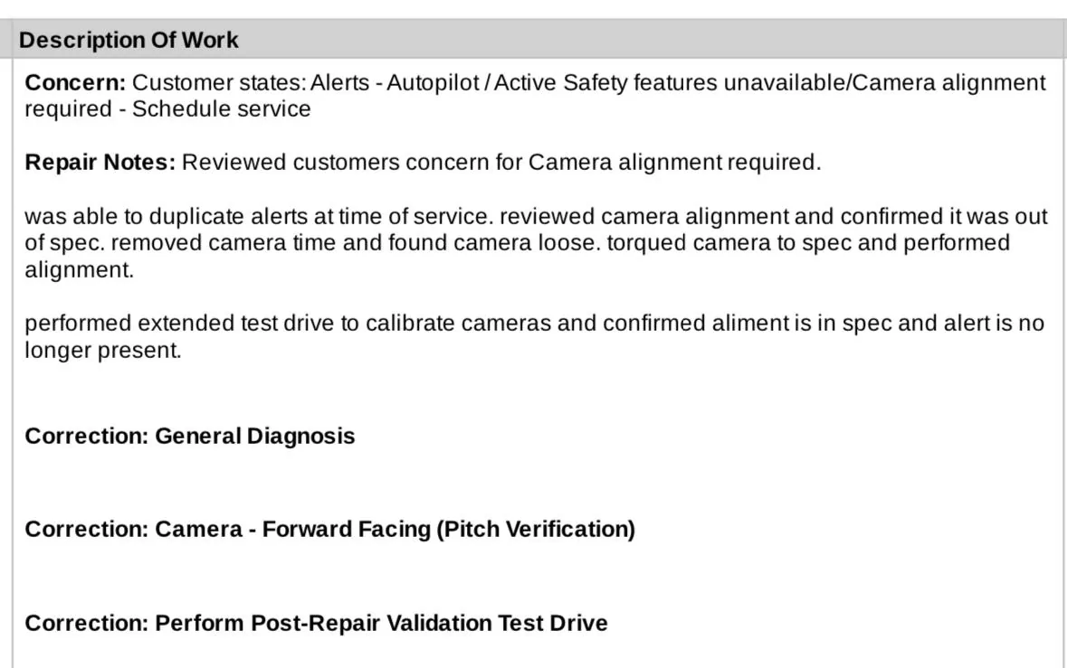

Woodrick
3,540
2,231
Gainesville Ga
Maybe I should try to calibrate first before going to the SC. I didn’t think of that
Looking at the service report, it suggests that the camera is loose. Which means that you may be able to realign it, but it may move again and mess it up.
