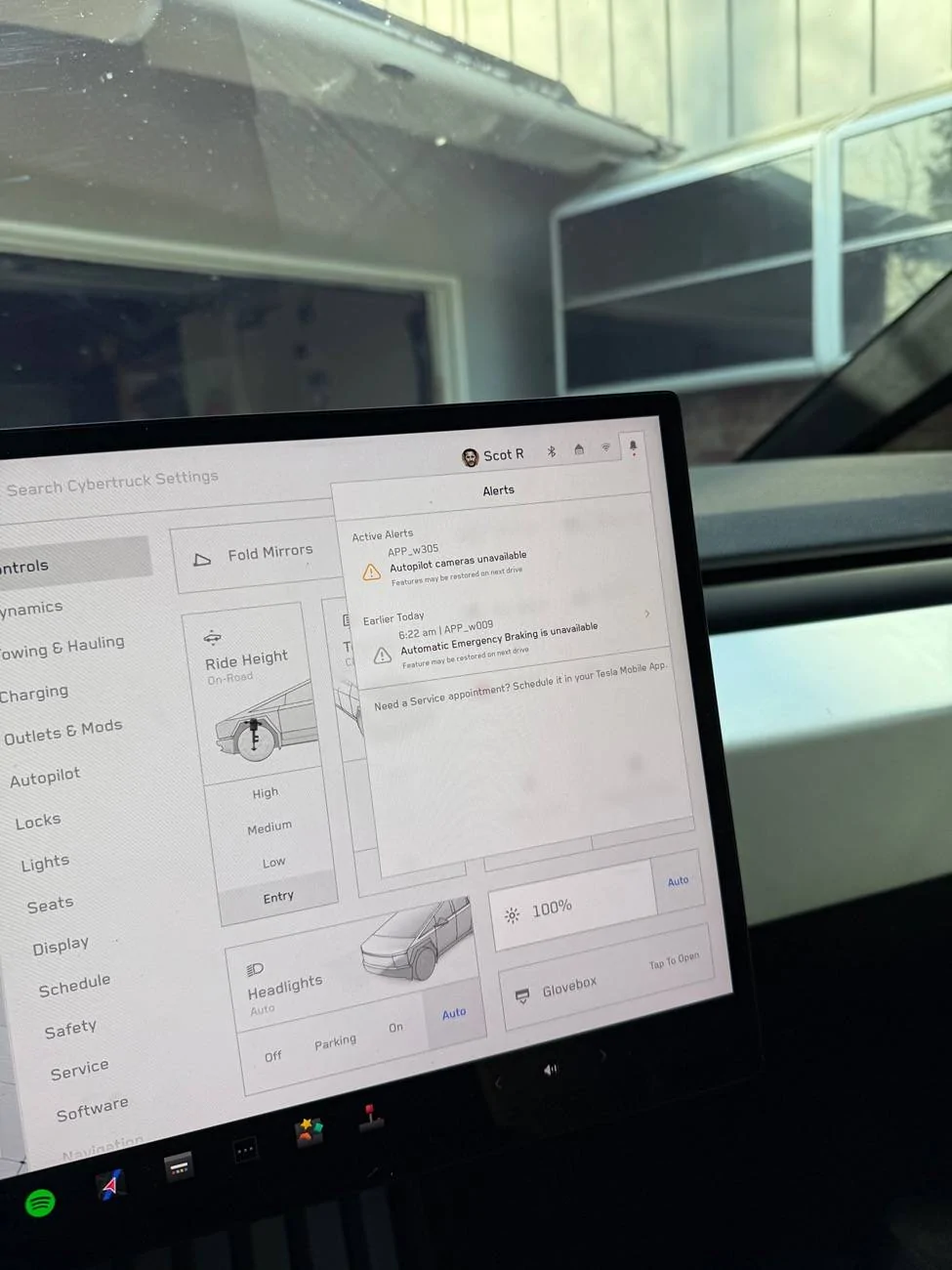

Just got this today. Nothing in the preview in car. Tried restarting screen but still no camera preview.
Without the cabin camera FSD is not available. Earliest appt. Is Friday in Santa Monica and I’m in the valley. They were offering 2nd week in February at a closer service center. Wtf.

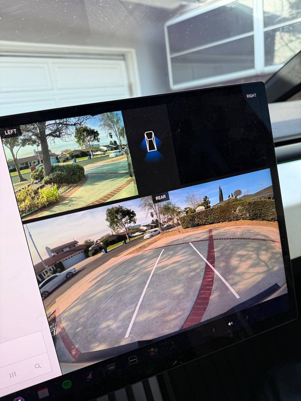

It fixed itself after 24 hours. Then camera stopped again. Then came back. A week later the right camera went out. No visualizations at all on screen. Did a screen reboot. Now works. Taking it for service on Tuesday.
