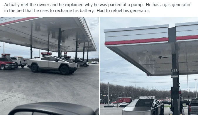

OP is this you?
Looks like someone is keeping a generator and gas in the back of their CT go get the range to get from one SC to another where they are spread out. In the same neck of the woods.

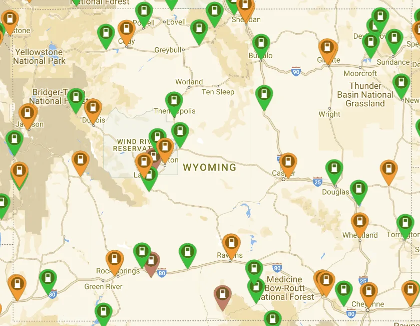

When you look at the map that @Jethro posted, charging options look slim. But let's look at Plugshare, slightly more options. @Jethro 's map had 12 Superchargers. This one has over 50 charging locations.
And I suspect that there are a number of camprgrounds that you could use as well.
