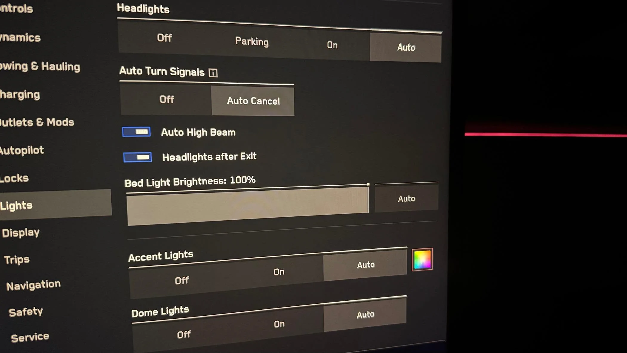

Bed light stop working when open Tonneau Cover !!

I did reset, still not working
is there place where turn it on off?

think the tailgate button acts as on off - one of those back there does

"Bed Lights: The lights running on the sides of the truck cargo bed can be set to Off, On, or Auto. When set to Auto, the bed lights turn on when Cybertruck is parked and the tonneau cover or tailgate is open. You can also toggle the tailgate button to turn the bed lights on or off for your convenience. See Cargo Bed for more information."
https://www.tesla.com/ownersmanual/cybertruck/en_us/GUID-C024712C-68DF-4914-8F8B-F5086A075C87.html
This should solve it. If not, you may need to make a SC request.

I think there's a bug with this. when I open my tailgate, or tonneau, the light turns on and then back off. But if I hit the tailgate or tonneau open button a second time, the light comes on and stays on. it's repeatable behavior, that's why I suspect it's software.

Look like there is away to turn it on and off . It Was off after last update ..
