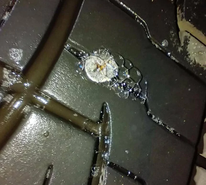

Got an alert that a tire was low, looked over it, found a screw (great).
BUT it was pretty much dead center of the tire, contemplated putting a plug in it myself but for $30 decided to take it to Tire Kingdom as they do Tesla/Rivian tires daily. Know how to properly lift an EV, foam lined tires etc.
Got a call 3 hours later that they tried two patches, and both failed. Suggested a new $555 tire, although suggested I buy it from Tire Rack as they did not stock it, so no real financial motivation on their end?
Anyway, anyone had an issue getting a tire patched? Service guy says he buffed inside down to clean rubber, did all usual steps, has been plugging tires for 15 years but this "is an odd tire and no idea why it is still leaking, maybe the patch nipple will fatten up and stop the leak"
Pics of the before below.

Did Tesla OK you to drive on the tire once plugged/patched?
A day later soapy water is still bubbling on the tire patch/plug so it has a slow leak.
I have heard that Tesla won't patch a tire and wants to always replace for liability reasons.

Maybe try a plug instead of patch.
Their glue could have been bad/contaminated.
Supposedly with EV tires (lots of torque) patches with a plug component are the way to go, unfortunately didn't work and had to cough up $600 for a new tire.

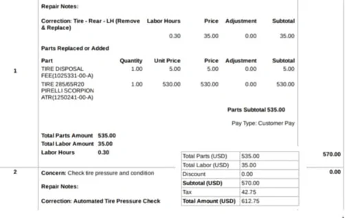

Final cost was $612 for a new tire, after having a screw dead center in the tread on a newish tire with less than 2k miles on it that stung.
Most concerning was the lack of availability of the standard cybertruck (core) tire from any shop other than Tesla.
