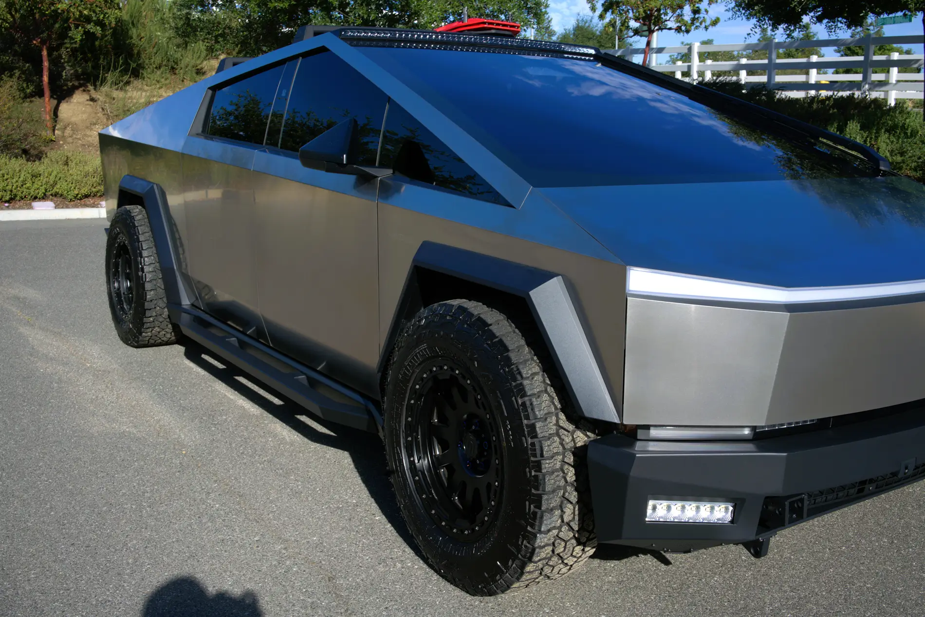

Running Wildpeak AT4W's on UP's -03 beadlock wheels. About 2k miles in. Heavy wheel and tire combo, so much so you can feel the heft on takeoff from stand still. Not as sprightly as the stock wheels and tires. It does feel good on pavement still however, no hum or vibration. Obviously better traction offroad, grips confidently on dirt both wet and dry conditions (was running them around 25psi). Would blast through so fast through the dirt sometimes I would inadvertantly disengage offroad mode :ROFLMAO:.
Obvious con is the range hit. On stock wheels and tires my effiency numbers was around 400-450 Wh/mi , compared to now 500-600 Wh/mi ! Definitely not practical as I am primarily a city slicker / weekend warrior, but Im happy with the decision. I also kept the stock stuff for swap outs if Im going on roadtrips.

Surprised at the magnitude of the range hit. I understand the theoretical benefits of the beadlocks off-road, is it easy to appreciate when you drive that way? With 25psi?
feel pretty different?

I was surprised too! Regarding the beadlocks, I couldn't tell you regarding the tire locking ability as I've never run PSI levels that low on a standard rim or ever had a tire slip off before, and frankly dont want to experience it especially out in wilderness. I can say that in my limited experience with doing light-moderate difficulty trails that the ride has been a blast so far. I do intend to push it harder to see what it's really capable of in the future especially now that Im also carrying a full sized spare as a fail safe.
