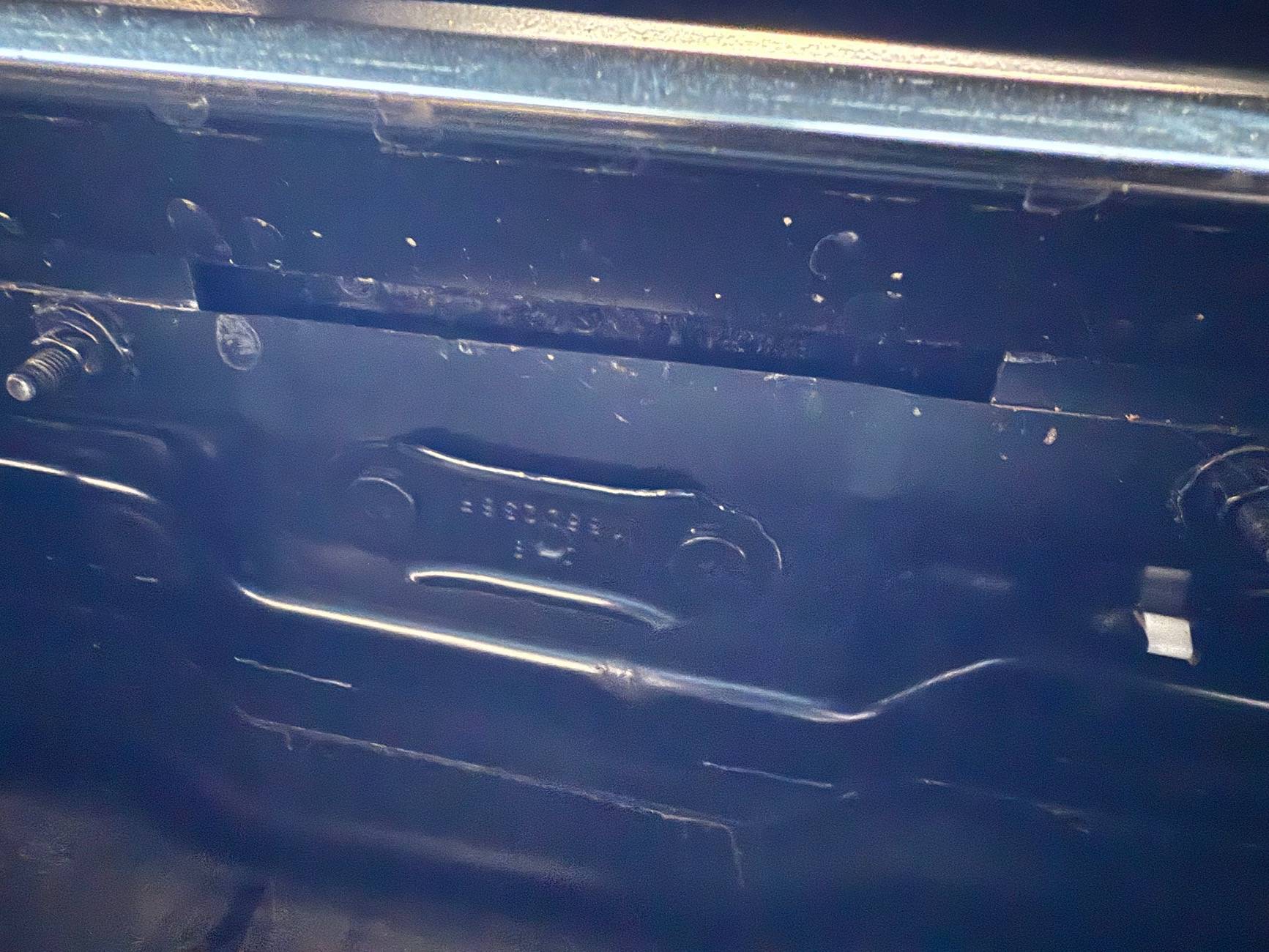

The posts are one piece, not removable, inserted from below (with adhesive most likely). Here’s a picture of the underside:

Advisor mentioned it’s the cantrail stud plate and is welded on.

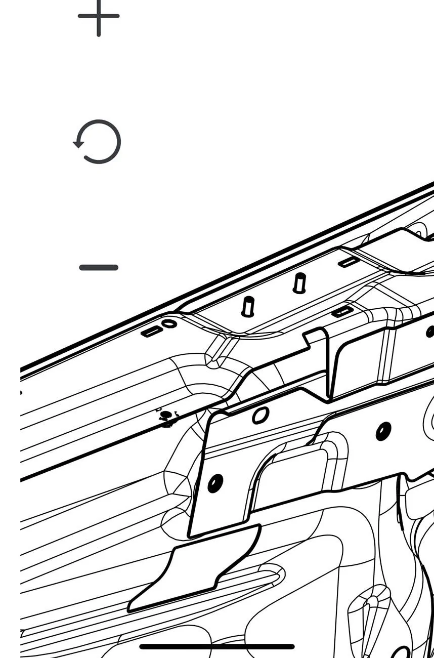

Wonder if I’ll need a new part 11? Zoom in on part 12 seems like that area will be impossible to get to? Would new panels have completely different shades of gray?
Tesla Roadster 2nd gen Rear driver side mounting posts missing Parts Catalog
Tesla Roadster 2nd gen Rear driver side mounting posts missing IMG_0545
wtibbit
Wayne
Aug 27, 2020
732
504
DFW
Isn't that unit two studs with a cross plate? If so, it's not the adhesive that would let go if over torqued, but the press fit/ rivet.
Could be. Either way, it would be bad to over-torque those studs so their attachments fail.
3,501
3,023
It looks accessible, with long jawed pliers. Question I have is what Tesla would allow in terms of attachment method given the assembly wants to be flush.
