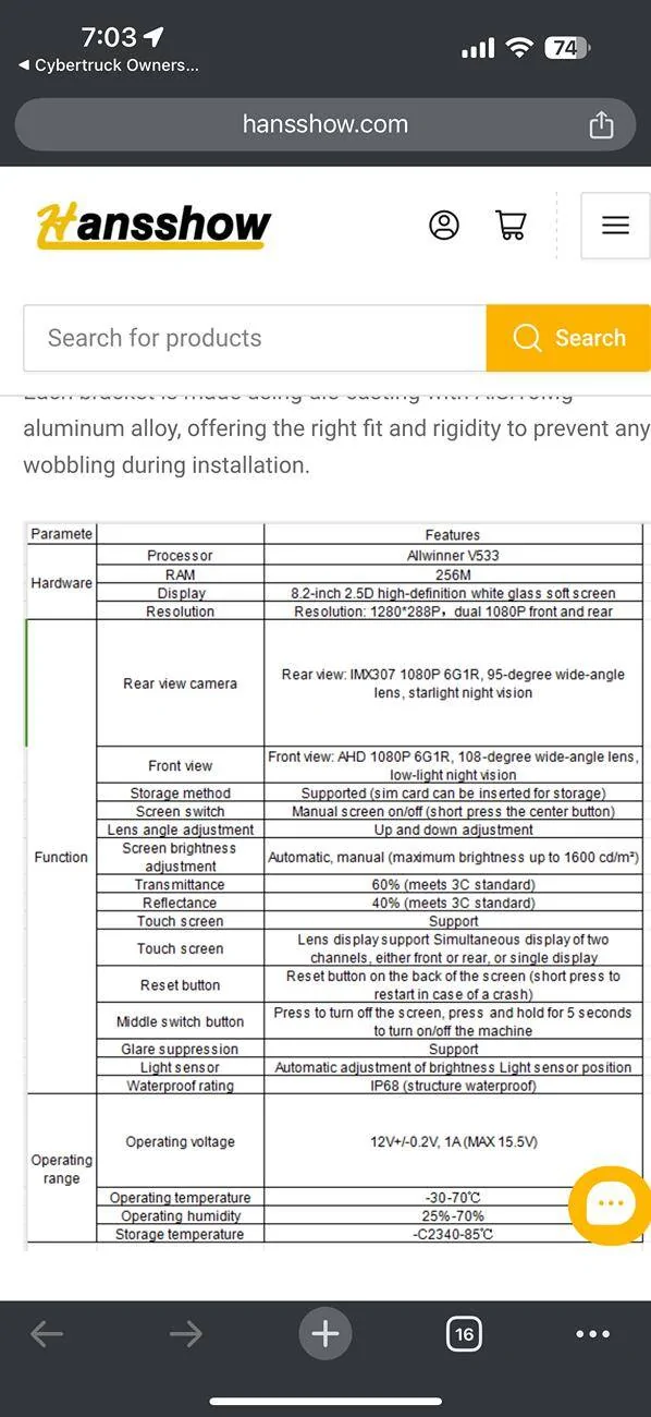

I would love too if I ever hear from their tech support. Emailed and chatted asking how many amps this pulls to make sure not to overload the circuit with my radar detector. No response yet, even on the live chat where they "respond in minutes."
There’s a specs table at https://hansshow.biz/3ChZiu7 that says -
Operating voltage: 12V+/-0.2V, 1A (MAX 15.5V)
So it looks like 1A, but variable voltage.
