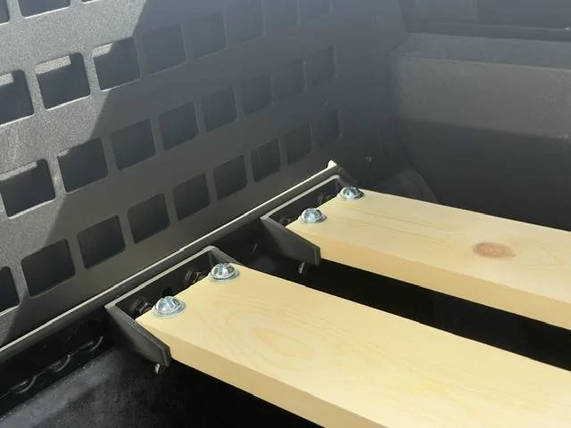

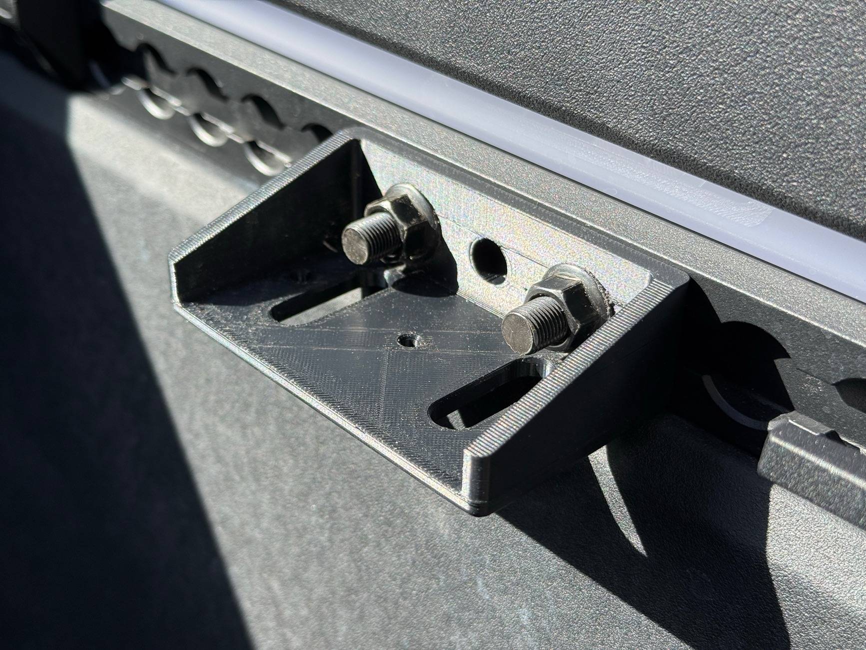

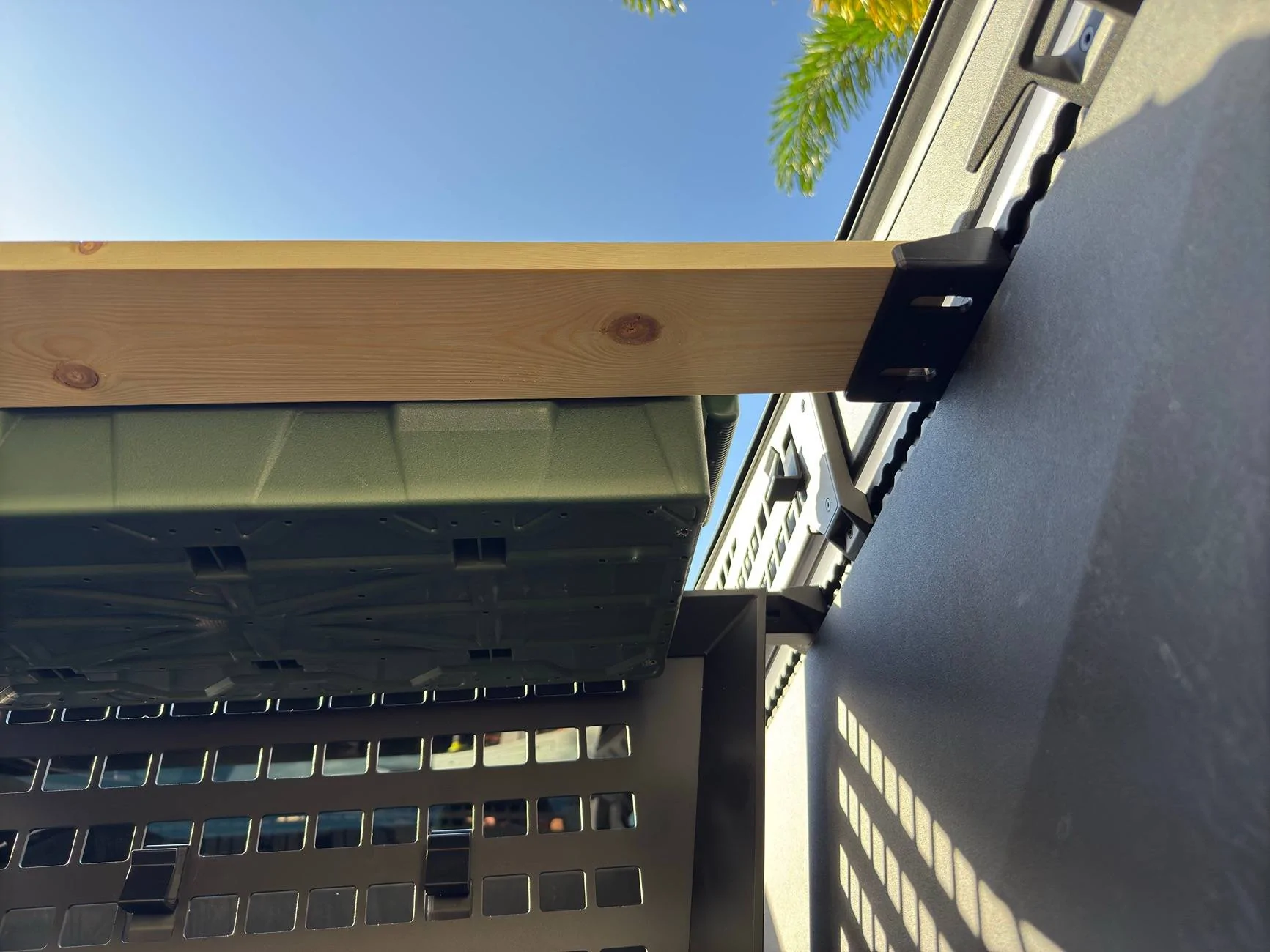

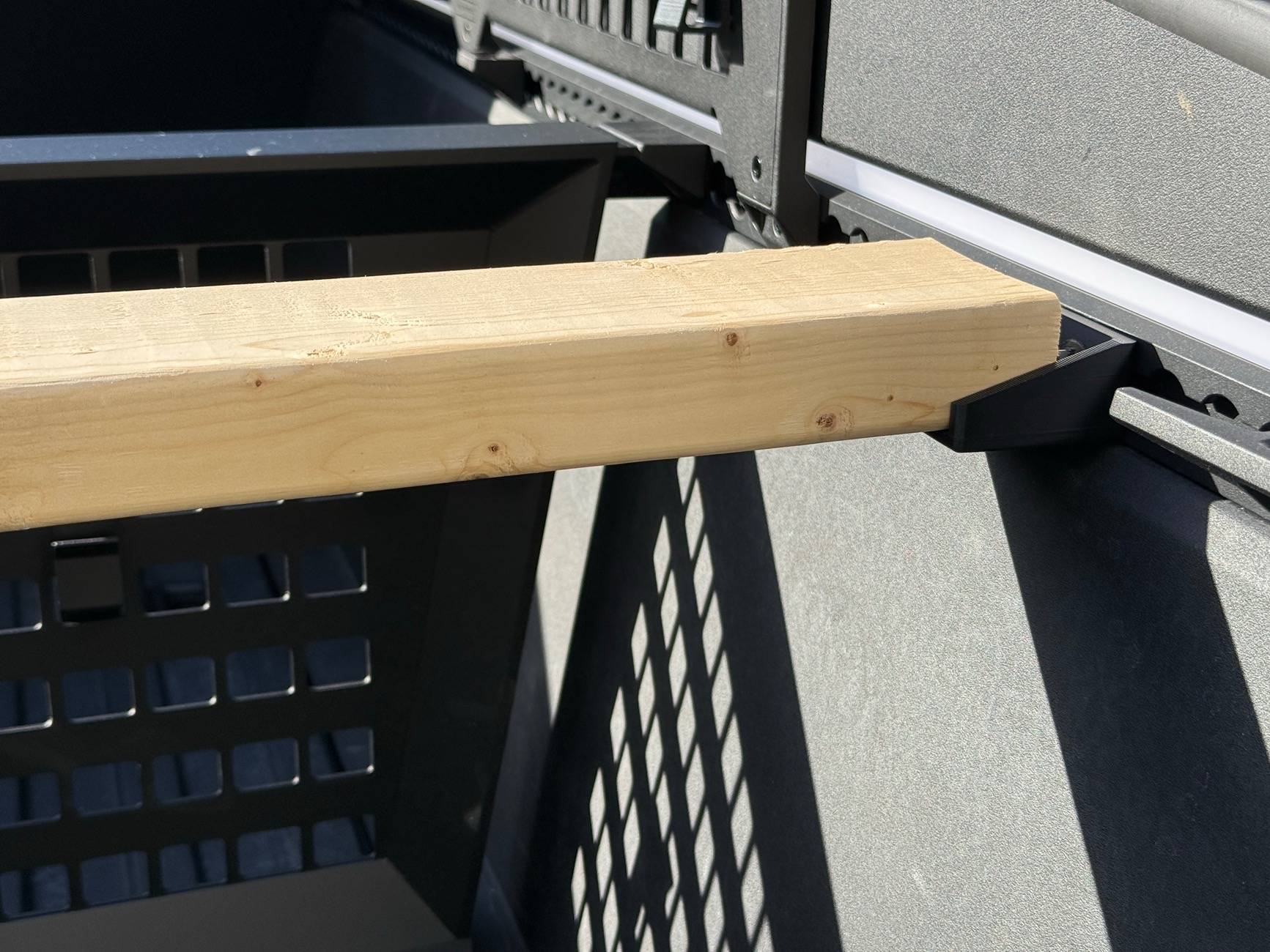

@alockbox what size are the carriage bolts holding up the 2x4 bracket?
They're not actually carriage bolts to the best of my knowledge, though they have similar properties. In my case, I'm using M10 L-Track Studs (in black). They are flat on the back and have a much larger head unlike a carriage bolt. The square profile is also larger than I've seen on equivalent carriage bolts. I wish they were carriage bolts they'd be a lot cheaper to obtain.
Regardless of which dimension you choose though, the L-Track studs have either a square profile or a wing profile (pictured in the natural finish), to lock them in place. The Tesla-supplied ones (pictured in black in hands) I was just commenting I can't find anywhere.

They're not actually carriage bolts though they have similar properties. In my case, I'm using M10 L-Track Studs (in black). They are flat on the back and have a much larger head unlike a carriage bolt.
That helps, thanks!
