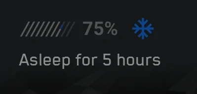

Has anyone run into an issue where you set the maximum charge to 80% and you leave the truck sit for several days only to find out that the SOC has dropped by 3% or 4% and the truck isn’t topping it off. I’ve had three Model Y’s, and I’ve never experienced this but the service center says this is normal. The truck is going to sleep and sentry mode is turned off, but it just seems since it’s plugged in it should keep it somewhere near the targeted state of charge.

Yes it's kind of annoying. At some point it will top up again. Not sure where that line is, but mine topped up several times while sitting a few weeks in very cold weather. You can always just bump it 1% manually to start it going as well.

It's normal and the SOC will be reported lower if the pack is cold.
Says 75%, is really 78%, will charge by 77% or so...
If you’re in a cold weather environment, this is most likely the answer.

Yeah, I know what you’re talking about there. Typically you get that little blue mark on the state of charge indicator when it’s cold and the SoC goes down until you precondition and or get the battery up to temperature in someway.. This isn’t that. Happens independent of temperature. Interestingly enough, I have a model Y performance that sits right next to the truck, so I can compare and contrast how they react to sitting for any length of time, whether it be cold or warm out. Understanding they have different batteries and different battery technologies. I’m just trying to figure out whether this is normal for a cybertruck or not
