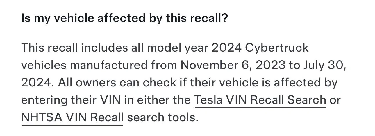

I’m confused by this statement in Tesla’s website as I took deliver of my truck in June 2024 and assume mine was manufactured between these dates, however it shows no recall in the search. Anyone have any clues?
Tesla Roadster 2nd gen Cybertruck inverter recall IMG_4518
I am thinking the affected inverters probably where not put into cars contiguously. So a June VIN could have used the newer inverter but a July VIN used the older part. The VIN tracker is what you want to go by and not necessarily the production date.
There were only about 2100 VINs affected by the recall and they were identified by specific number. If it didn't pop up for you then you shouldn't have anything to worry about.
3,489
3,010
Weird it says 'all' when they often say 'some' or 'specific'.
The actual recall paperwork does use "certain":
The subject population includes certain Model Year (MY) 2024 Cybertruck vehicles
manufactured between November 6, 2023, and July 30, 2024, that are or were equipped with metal-oxide-semiconductor field-effect transistors (MOSFET) in the drive inverter. The affected population includes vehicles equipped with Inverter Part number family 1802305 containing MOSFET part number 1530063-2A-B
https://static.nhtsa.gov/odi/rcl/2024/RCLRPT-24V832-7628.PDF
