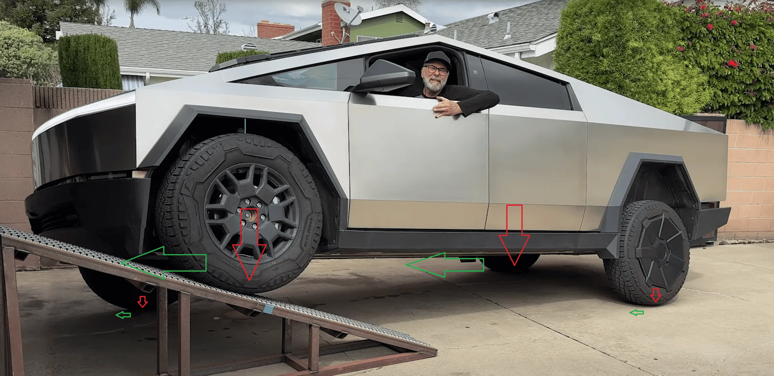

Rock Mode Cross links according to the manual
Tightly manages tire slip to maximize grip in rock crawl conditions and sets the Preferred Ride Height to Very High. When the ride height is Very High, the suspension system pneumatically connects the springs on the front and rear axles, increasing suspension articulation for maximum traction.
But he may not have been in Very High / Rock Crawl mode - guessing most don't know this and arent when they're shooting vids.
Hoping the cross link is legit and I plan on getting disconnects for the swaybars!
Well that is great news that it does that, but it sounds like it is only passively doing so which might not be good enough?
I also think it might highlight a similar problem as shown in the video, and that is that a higher airbag suspension setting makes the airbags harder to compress overall to keep the clearance height.
An active system would only allow pressure to flow between the appropriate airbag for the articulation required and monitor and maintain clearance whilst doing so, and the overall angle of the vehicle as to avoid a suspension induced roll over whilst transversing a slope.
Now if it is an active system and does this, then the percieved "stiffness" can only really come from the stabilizer bars, meaning a stabilizer disconnect should be a factory option, otherwise one system is compromising the other. The Rivian has them too, and they aren't a big cost item. A KDSS setup would be best as it is always on and works at any speed and in any condition without user interaction, so you can go from full articulation rock climbing to low body drifting on a track in a second. An aftermarket KDSS shouldn't be to hard either.
