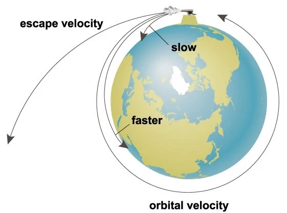

So if you want to launch something into orbit, what you really need to do is head for space, once you get there you go sideways to get faster to stay up.
That is also why there is a big difference between being high enough to be in space, like Blue Origin and Virgin Space do their "flights" (or weather balloons can nearly get to), and being in orbit like SpaceX. Being orbital means you have reached orbital velocity, meaning you are travelling fast enough to perpetually (nearly - think of earth orbit around sun) fall around the earth and not lose altitude and crash back to earth.
Tesla Cybertruck Concorde launched micro sat. 1*4Cp3qiY-jS8gIFR8F5qOG
As you can see in the diagram above, velocity is what keeps you up in space. Don't go fast enough, you come back down after a short period, go fast enough you keep going, and go to fast you leave orbit and head somewhere else in the solar system. :alien:
Technically, if the earth did not have a atmosphere, like the moon, you could actually reach orbital velocity a lot closer to the surface. On the moon you can actually shoot yourself in the back with a decent gun/cannon, with the projectile circumnavigating the moon. :oops:

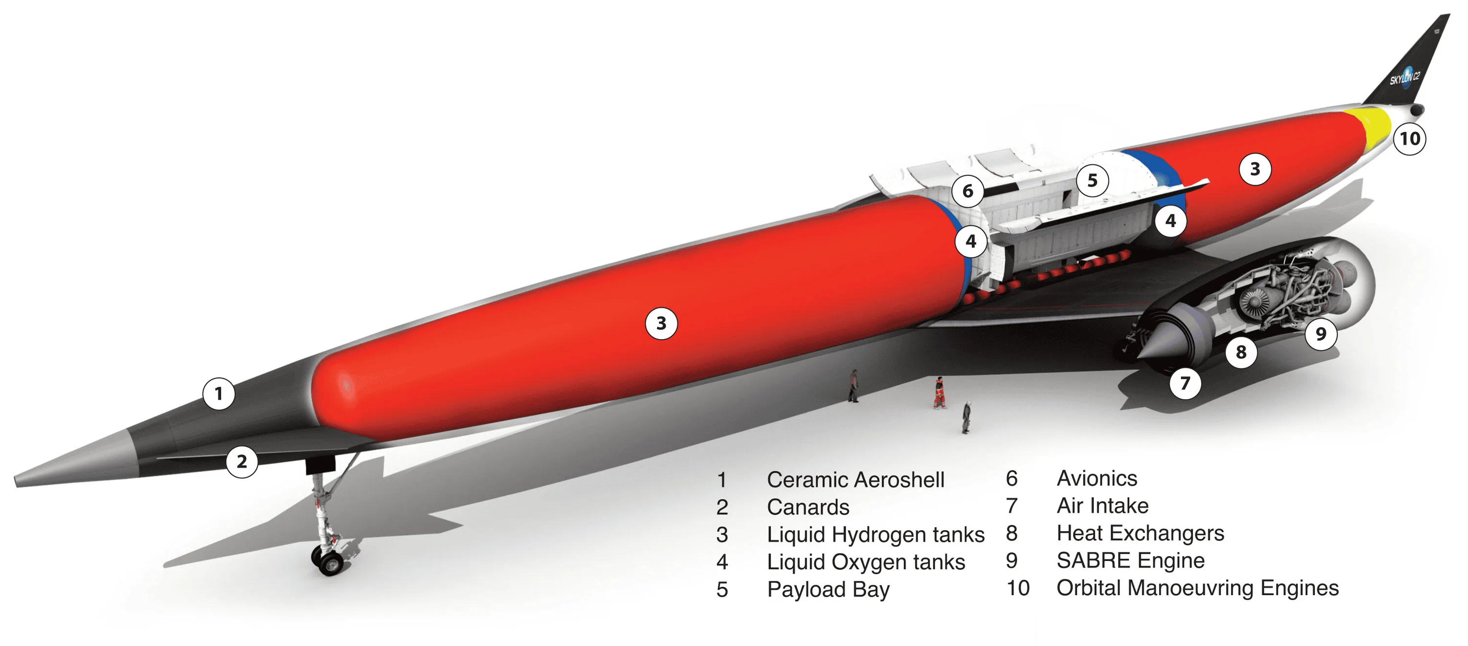

Now if you wanted to make a spaceplane then you can actually use the air/oxygen available whilst you climb through the atmosphere as more than half of your fuel source, instead of carrying an oxidizer with in rocket tanks. Raptor on Starship is around 3.8 parts LOX to 1 part CH4, so you could have a LOX tank probably half the size in comparison, because at higher altitudes where the air is to thin, you will still need thrust to maneuver, so you have to take LOX with too. This is fairly complicated to though, as your engines will have to go through various modes depending on altitude and velocity. SABRE is well on their way at achieving this:
Tesla Cybertruck Concorde launched micro sat. 1659785942425
As you can see still really a flying fuel tank with limited payload (5) but it does look cool.

If you want wings to make use of the air as a oxidiser and for lift, I'd just go the SABRE engine route. Single reusable launch vehicle that can land and takeoff on a runway. Brilliant. Technically, financially and physically that makes sense in comparison to Falcon, but Starship in another league because they have pushed the mass fraction (3.6%) by making it huge which then works in their favour. There's simply no runways big enough to make that work with wings.
