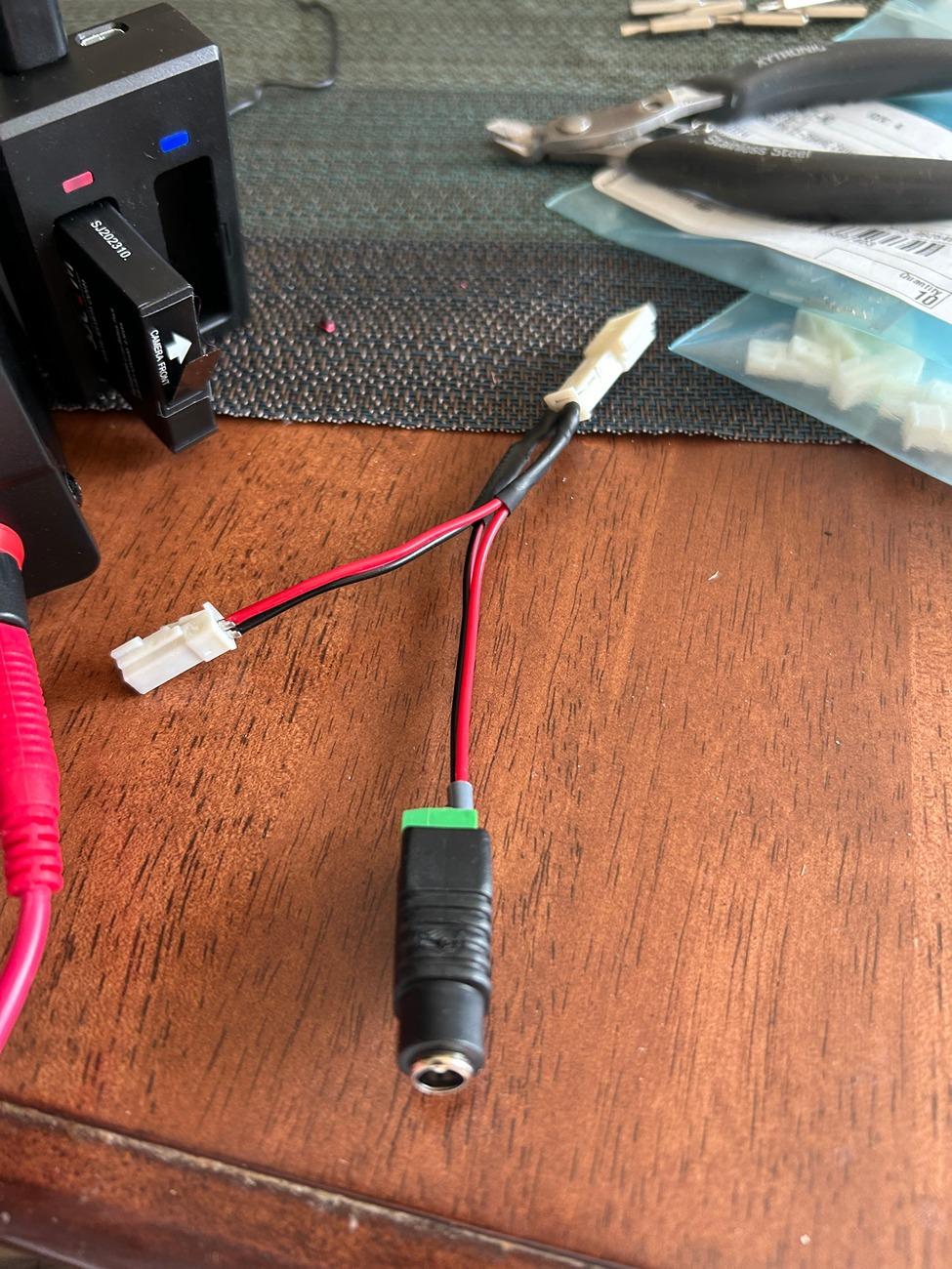

I followed the everyday chris video to remove the mirror and to open the autopilot housing. Inside there is a red and black wire 2 pin connector. I found the connector in the tesla schematic and ordered parts from digikey to make an inbetween connector. This connector then "T"'s the red and black signals to a DC barrel jack. This way if there is an issue in the future I can totally disconnect the power and voltage step down. Here are some photos of the process.
Below is the cable assembly. It is about 2-3 inches in length which was just enough to exit the housing cleanly.

I disconnected the red/black wire housing from the clip in the triangle cover. Then put the dongle inbetween the two connectors. Then I closed it up without pinching any wires.
