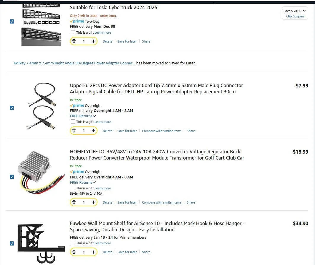

I like to camp in the back of my Cybertruck, and my CPAP machine gets in the way. Drawing power from the 110V outlet using a power supply is inefficient.
This is what I have in my Amazon cart:
Tesla Cybertruck Camp mode with CPAP machine - roof power supply tap, 48V to 24V converter, CPAP shelf, Molle panel. CPAP_Plan
The barrel connector is what my Resmed Airsense 10 needs for a 24V, 3.75A (90W) connection.
My plan is to mount the shelf to a molle panel on the side of the truck bed, and put a connector on the roof tap. When setting up camp, get 48V power from the connector to the 48V to 24V buck converter attached to the shelf. I'm assuming when I put the vehicle in camp mode, I can leave the roof tap power on.
It just occurred to me that routing the 48v power feed into the back while allowing the tonneau cover to close will be a challenge. On solution is just use a long 48v cord and route along the bed and up in the gap at the bottom of the tailgate. It is only needed when camping, so OK to run the cord along the outside.
Any suggestions?

Hi, Scott;
I think it sounds like a great plan.
You can route a cable from your rooftop 48v feed along the trough covered by the plastic cover/appliqué into your truck bed emerging beneath your tonneau cover. I used the following XT60 cable and routed it by clipping off the connector on the bed-side end, routing the cable into the truck bed from the rooftop feed, and then I soldered the connector back on and heat shrinked the solder joints.
Just ensure that the cable is located out of the way of the moving tonneau so that the tonneau does not abrade your cable.
If you take off the rooftop appliqué and follow the channel you’ll see pretty immediately where to route your wires.

I've tried the dcdc converter for lighting accessories - one thing I can tell you is the cybertruck 48v system doesn't like it. I need to constantly reset .... [/USER]
Your buck converter had presented a problem. It could be that it was drawing more than 400 watts, or that it was shorting out, or that it was defective. I use buck converters of the type listed by OP all the time and my CT has had zero issues with them. He should have zero problems with his as well as it draws much less than 400 watts….
possible. one thing I found is the rated power spec on these devices is ... always exaggerated. I probably was getting too close to the rated power.
