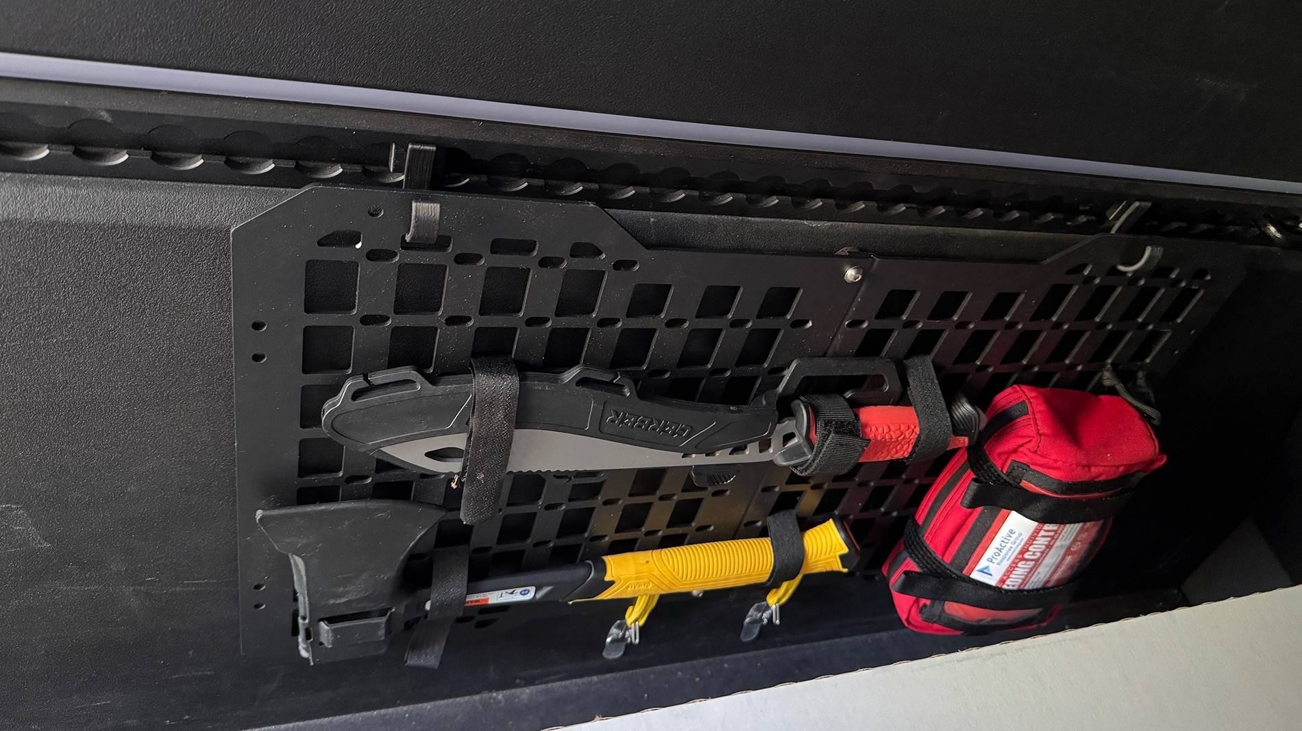

I use my truck for a lot of different things, so I wanted to be able to quickly change out my “Loadout.” If I need to load up my bed with stuff, I want to easily remove my camping stuff, etc.
To do this, I used a cheap seatback Molle Panel on Amazon (https://a.co/d/7dR08Fg), 3D printed “Airline Hooks” that work amazing on the L-Track (https://svelte.printables.com/model/771061-airline-hook), a few felt pads, and until I find something better… command hooks with rubber bands to keep the panels from flying up on a big bump.
I plan to have 2-3 of these panels loaded up with things I use together. When I need something else, I just swap the panel out. Or remove all the panels.
I’ll eventually modify the hooks for a more custom fit and find a better bottom mount solution.
Any feedback or improvement ideas welcome.
