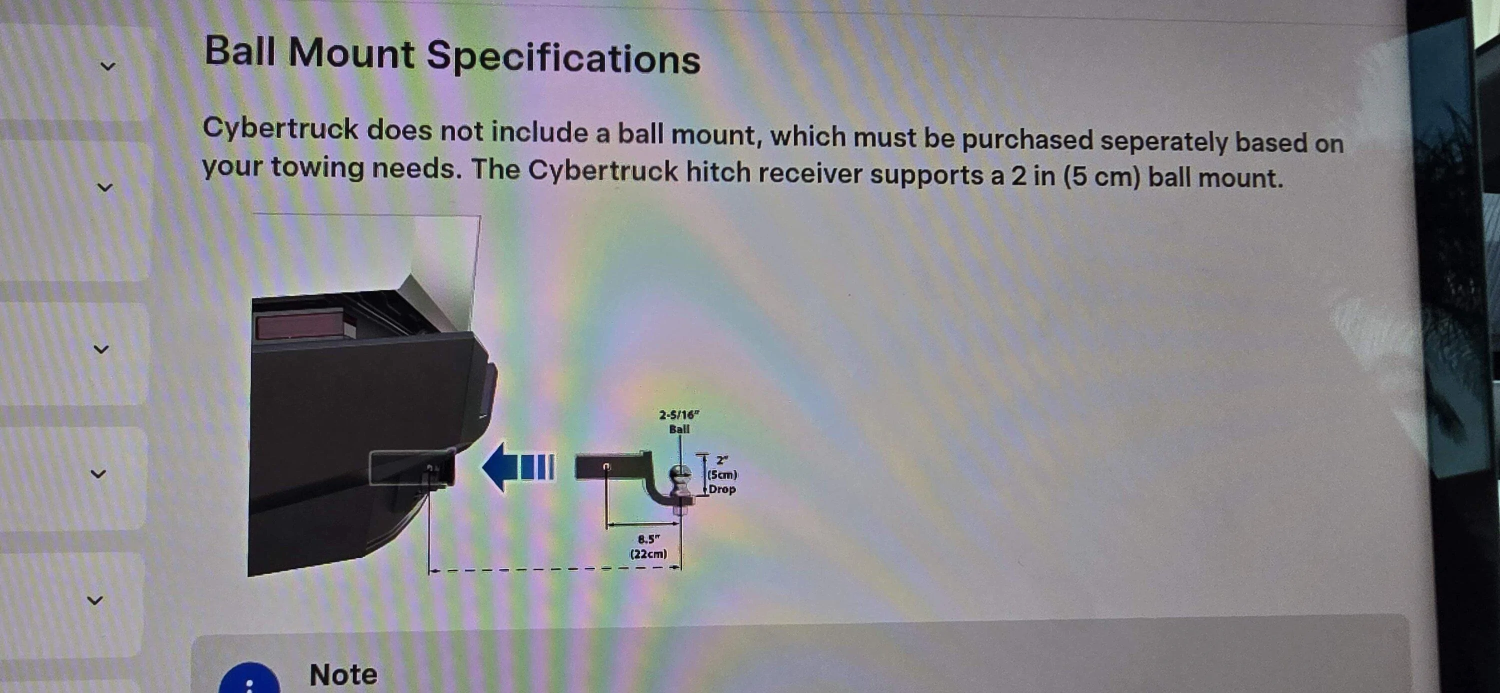

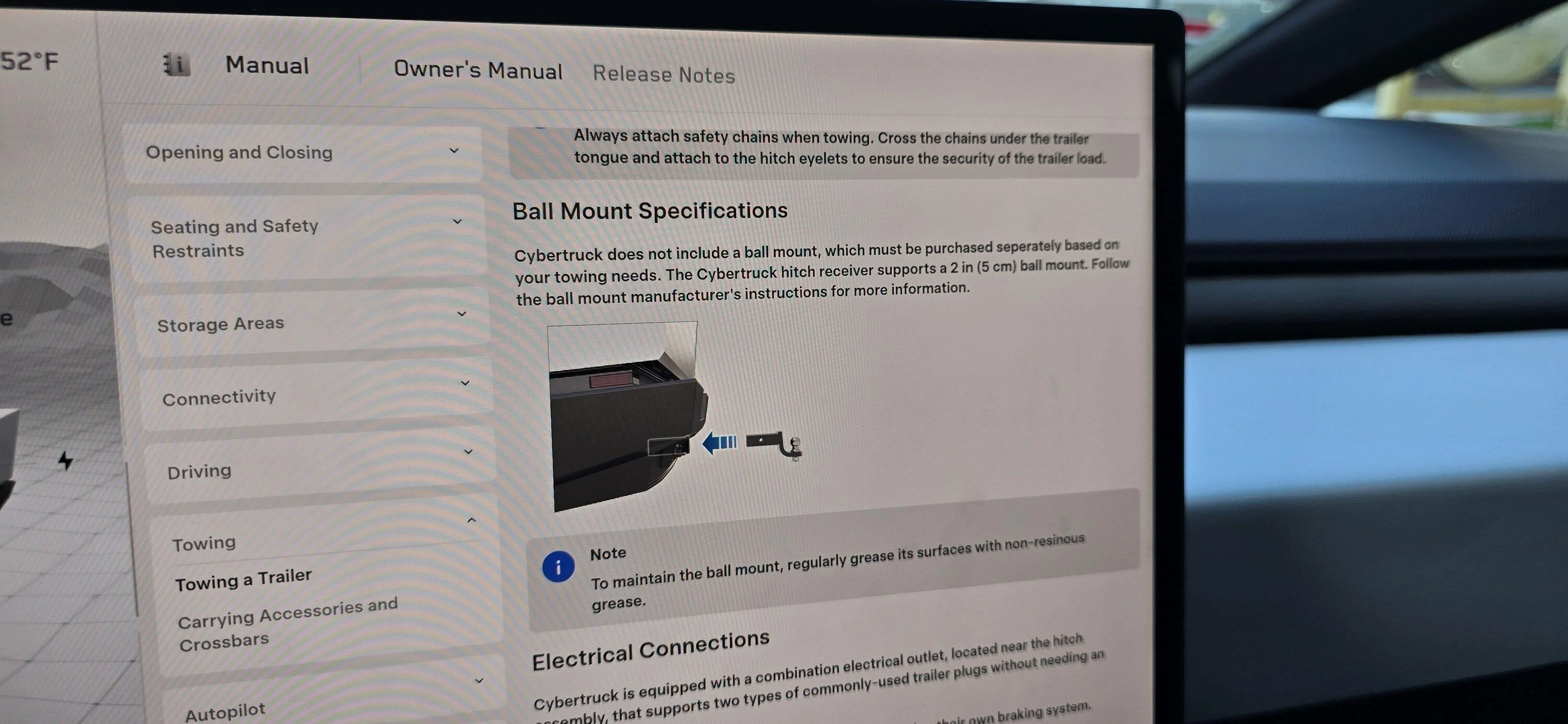

Just so I understand, there isn't a specific size of ball mount required for the Cybertruck right? When I look at the manual it doesn't give any specific length requirements like it does on the Model Y manual. So you just get a 2" hitch that supports the amount your are towing?
Tesla Roadster 2nd gen Ball mount for towing 20240201_171514
Looks like they updated the manual since I posted this:
Tesla Roadster 2nd gen Ball mount for towing 20240215_171637

For the Y they have very specific dimensions of the shank. That's mainly what I'm asking. Makes sense to keep the trailer flat but the problem is for now I plan on renting a camper so I don't get know what kind I will be renting. So I want something versatile enough.

FYI, I updated my original post, they eventually updated the manual with similar requirements like the other Tesla's that can tow. The problem for me is I already bought my shank, hopefully it will work.
