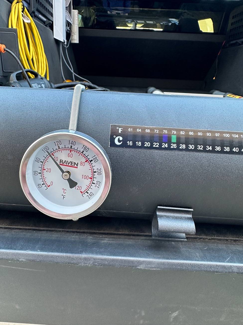

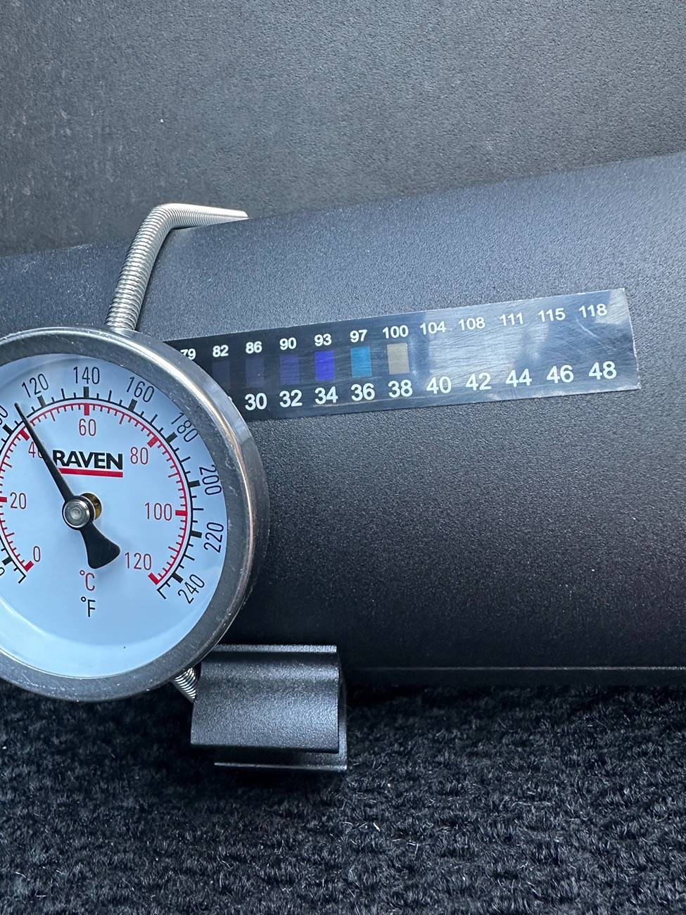

I added a thermostat so that my Cybertruck’s water heater shuts off when the water reaches 118 degrees F (47 degrees C).

The RoadShower has a few quick-connects. One is a shower head and the other is a spray nozzle. I suggest buying both. The shower attachment is separate from the RoadShower unit itself but worth it IMHO. The RoadShower has a Shraeder valve that lets you pressurize the tank with a bike or tire pump. It also has a pressure relief valve that pops around 55 PSI. It has 2 connection points for 1/2 NPT. One of these will be where you add a heating element using an adaptor. The other is for your water delivery point / water hose / shower head. Enjoy, fellow Cybertruck nuts!

(5) When you want hot water, turn on your roof accessory 48 volt feed from your awesome truck’s touchscreen! Make sure to monitor the water temperature as there is no thermostat as described. Use the sticker thermometer that comes with the Yakima RoadShower and make sure to test the water before using it so that it doesn’t burn anyone. If it is too hot, add some cold water to the RoadShower until the desired temperature is achieved.
(6) I added a temperature sensor to the exterior of the RoadShower (the canister is aluminum and magnets don’t work) that I purchased through Home Depot and then added a longer strapping wire to fit the circumference of the RoadShower.
Water Temperature 30-40 minutes AFTER Applying 48 volt Roof Accessory Voltage.jpg
Water Temperature after about 75 minutes of roof accessory power applied.jpg

This is the digital thermostat I added bought from Amazon. It is technically rated at up to 30 volts but runs fine off of the Cybertruck’s 48 volt accessory roof feed. It is very simple to wire up as shown in the attached photo. (In the attached photo the proper wiring is the schematic at the top of the photo, not the bottom schematic.). A few tips: all wires can be fished from both the Cybertruck’s roof accessory line and the Yakima Roadshower heating element from above the tonneau to below the tonneau in such a way to not interfere with the tonneau’s movement. I housed the Drok thermostat in the ESD bag that it came in and mounted it to the bed’s Molle panel. To do so I taped a bunch of electrical tape to the rear of the circuit to prevent any short-circuiting and then taped the esd bag shut around the exposed-wire end. I put it in a position where it is both out of the way but where I can also see it from the secondary camera feed for the TesStudio S92 digital rearview camera (the secondary camera feed was designed to be a forward-looking camera but I’ve got it looking at the rear seats of the truck and into the bed). (As an aside, I posted instructions on how to ditch the TesStudio wiring harness for the S92 to avoid the associated phantom alarms/alerts relating to the truck’s speaker system if you search for it in the forum.). But back to the secondary camera feed, when I use the touchscreen to turn on the truck’s roof top accessory feed I can instantly see the digital display of the thermostat light up, and there is also a red LED on the thermostat that lights when the circuit is under load , telling me that the heating element in the Yakima Roadshower is being fed 200 watts and I’ll have hot water in about an hour to 90 minutes or so. One additional thing about mounting the thermostat circuit below the tonneau: I had to extend the length of the temperature sensor to enable it to be fished both above and below the tonneau cover. I used some camoflauge gauze tape to hold the temperature sensor in a groove of the aluminum Roadshower. Lastly, the thermostat could actually be programmed up to 110 degrees C, but for safety I’ve set mine to stop heating at 47 degrees C (118 degrees F).
Two takeaways: (1) there probably isn’t a more energy-efficient manner of heating water with your Cybertruck and (2) the Yakima Roadshower design is both out-of-the-way while being conveniently available.
