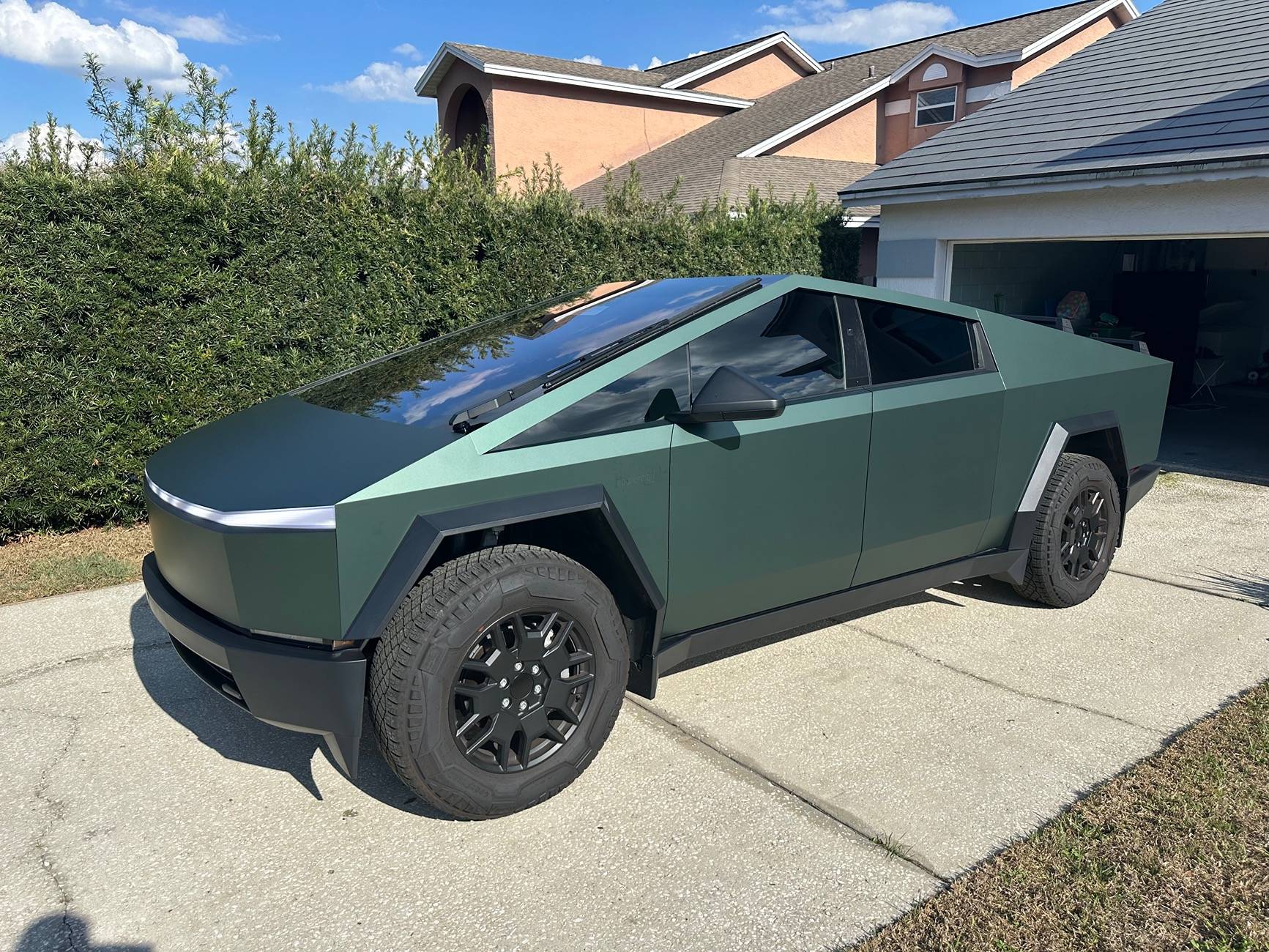

Wanted to share the results from the @TESBROS 3M Vinyl self wrap kit for the Cybertruck. I’m putting together a video going over the process with what I learned, but I’m pretty happy with the results.
It’s absolutely not perfect, but this was WAY out of my comfort level and any rough edge that you can see here and there is well worth the $5k I saved doing this myself!

It looks great. You did a good job!

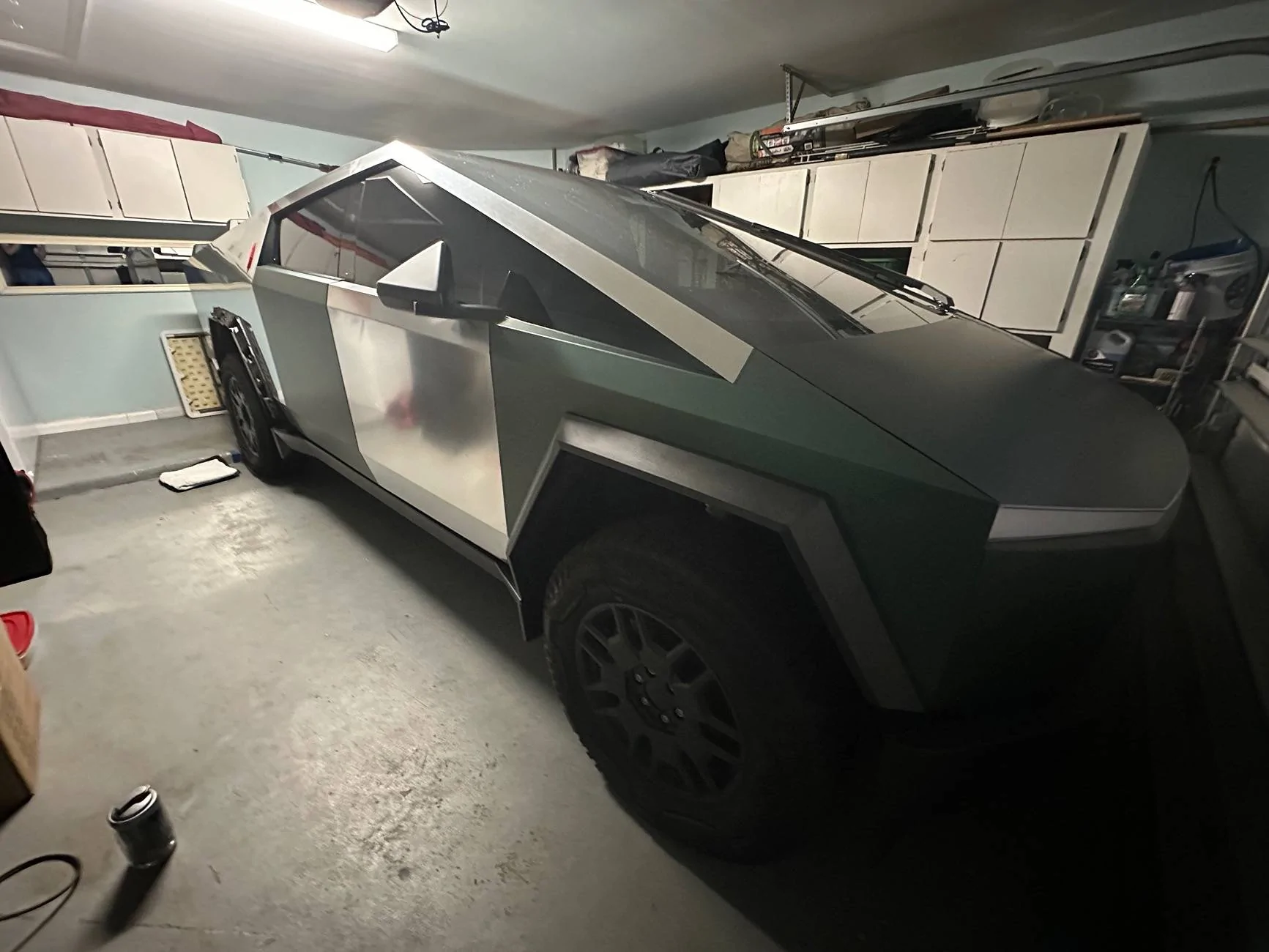

How long did it take you to install?
All told probably about 12 hours of instillation… the more I got used to working with the material the faster it went… I was able to finish the driver front fender today in 35min… the first door took 1 hr, second 45min, third 35, and last one was finished in 30min with the best results of all 4
This is not including the time I took prepping the truck with a clay bar and removing any trim pieces to do the work.
I wish I took a week off work to do it all at once, but I ended up finishing over the course of 2 months. That did make for some fun photos though!

looks awesome. Great job!!!
