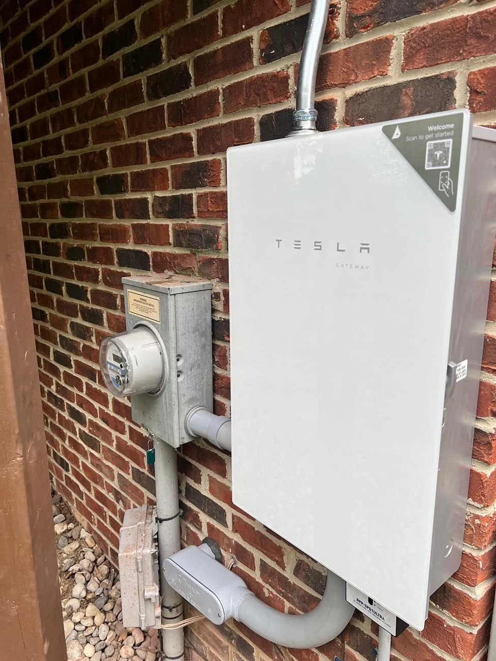

The Green Panel (from Brighton) just completed their 1st PowerShare install, apparently the first in Michigan (no way to verify their statement). They did a stellar job, the charger is in the attached garage, 65 feet from the PowerShare module, which is installed on the outside wall adjacent to the main power feed, exterior of the basement main electric panel. They went through 2 exterior brick walls, installed some 80 feet of conduit, perfectly straight with nice 90 degree bends, and created a clean drywall access along the studs below the breaker panel, and sealed it back up. Absolutely professional install. The configuration was a bit tricky due to a weak WiFi signal, and Tesla Tech took forever to answer their install hot line to validate the installation. Tesla subsequently whitelisted my address and VIN, and about 30 minutes later a software update came through that activated PowerShare in the app and the truck.
Total install was $5,064 including a surge arrestor, permit and taxes, with the Tesla supplied Charger and PowerShare module. I would estimate that it took their crew some 24 manhours over 2 days to complete the job. A lot of conduit, crouching under a deck, elevation change, a lot of wiring, a lot of detailed work. And they cleaned up a rather messy electric conduit install from a previous HVAC replacement while they were running their lines. “We have standards” the kid said and smiled.
A $1,519 tax credit (Residential Renewable Energy Tax Credit = 30%) should apply next year on my taxes, reducing the net install cost to $3,545.
As we had at least 5 power outages in the last 2 weeks, I will certainly put the system to the test real soon. Just charged to 80% at home for the 1st time, bring on the next storm…
